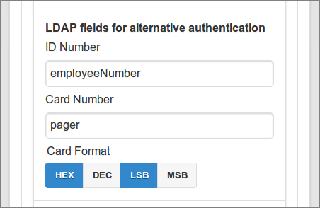

At the LDAP fields for alternative authentication section LDAP field names can be entered for the two alternative user authentication methods ID Number and Card Number, as described in Section 4.11.4, “User Authentication”. Field names are optional and can be left empty. The Card Format is relevant when the Card Number is specified. See Section B.1, “Card Number Format”.
The ID and Card Number must each uniquely identify a user, so make sure that no two users have the same number. This means that the numbers defined in LDAP should be unique. If SavaPage encounters a non-unique ID or Card Number that user will not be updated.
ID Number and Card Number LDAP fields are currently not supported for Google Cloud Directory.

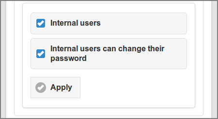

4.11.1.3. Internal Users
With the internal users feature you can directly manage users inside SavaPage. Enabling this feature removes the obligation to define an external User Source to create and manage Users. Of course you can enable this feature as an addition to an external source.
Admin Web App: Options - Internal Users
Figure 4.90. Admin Web App: Options - Internal Users
When Internal Users is selected extra options appear to enable Internal Users can change their password and Self Registration. See Section 3.10, “User Details” and Section 3.1.3, “Self Registration”.
To enable Self Registration, you must also enter a comma-separated list of email domains that users can use to register. In addition you can set configuration properties to override defaults.

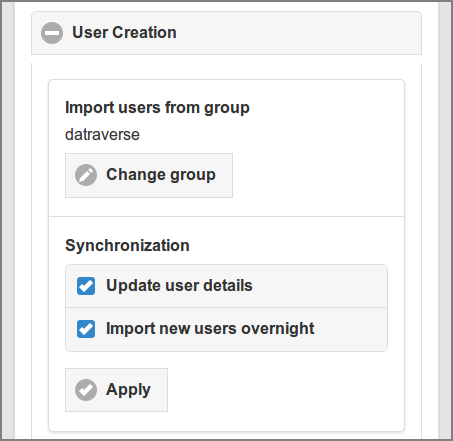

The Import users from group section holds an option to import a subset of users from the source by selecting a group. This option is relevant if you want to restrict access to SavaPage for a subset of external users.
Admin Web App: Options - User Creation - From Group
Figure 4.93. Admin Web App: Options - User Creation - From Group

The Synchronization section holds options for the external user synchronization process.
  • Tick the Update user details checkbox if you want to overwrite user details in the database with details from the source.
    An external User will overwrite an internal User with the same user id: as a result the User will become external.
  • Select Import new users overnight to automatically synchronize daily at 10 minutes past midnight. See Section O.3, “Daily Jobs”.
  • Press the Apply button to commit the changes.

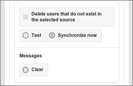

Press the Synchronize now button to manually start a synchronization.
  • Tick the Delete users that do not exist in the selected source checkbox to (logically) delete users in the database that were removed from the source. Note that this checkbox is deselected again after each synchronization.
  • Feedback messages from the synchronization process are real-time displayed in the Messages section. Press the Clear button to remove them.
  • Use the Test button to check the effect of the synchronization without updating the database. Messages are shown with a "test" prefix.
Disabled Active Directory users will not be imported by default. If you want to change this behavior you can set the value of configuration key ldap.disabled-users.allow to Y (or enter an empty value to fall back to the default). See Section 4.11.15, “Config Editor” on how to change this value.
To delete all external users, select - as User Source and use Synchronize now with the Delete users option.
The SafePages of external users not present in the source are deleted.

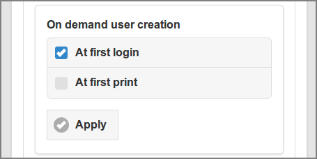

Admin Web App: Options - User Creation - On Demand
Figure 4.95. Admin Web App: Options - User Creation - On Demand
On demand user creation specifies which events, apart from regular user synchronization, will ad-hoc create new external users in the database.
  • If the user associated with these events is not in the database, SavaPage will check if the user is part of the User Source and thereby a sure Synchronized User candidate. If so, it will ad-hoc synchronize the user into the database.
  • Select At first login to ad-hoc create a user when they successfully Login to SavaPage for the first time.
    • This also includes an OAuth login if the OAuth provider uses the same (LDAP) user source that is configured in SavaPage as external User Source. This situation can be configured in the OAuth Plug-in properties file.
  • Select At first print to ad-hoc create a user when they print to a SavaPage queue for the first time.
  • Press the Apply button to commit the selection.

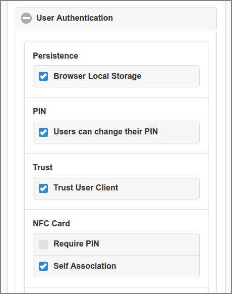

The Persistence section holds a options to persist authentication in Browser Local Storage. When enabled, a successful login to the SavaPage Web App will store an authentication token in the “Local Storage”[20] of the browser. When the user closes the browser after a successful login and opens it again, login will be automatic, without the need to authenticate again. Separate authentication tokens are held for the User and Admin Web App context. See Section 17.2.3, “Authentication Tokens”.
The presence of an authentication token is essential for the iOS Web Clip to function, and is pure convenience in other environments.
When Browser Local Storage is disabled, authentication persistence is implemented with Web Sessions.
The PIN section holds the defaults for PIN usage.
When Trust User Client is enabled User Web App authentication is automatic when:
The NFC Card section holds the defaults for card swipe logins using a Local Card Reader or Network Card Reader.
  • With Require PIN enabled the user must also provide their associated PIN. This provides additional security for swipe card logins.
  • When the Self Association option is selected, users are allowed to swipe cards previously not used or registered. When swiping such an unregistered card, SavaPage will ask the user if to associate the new card to their account. When the user agrees SavaPage will switch to User Name authentication. After successful authentication the new card will be registered, thereby replacing any previously associated card. This feature is available for User Web App Login only. See Section 3.1.5, “Card Self Association Dialog”.

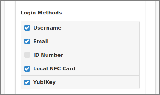

Admin Web App: Options - User Authentication - Login Methods
Figure 4.97. Admin Web App: Options - User Authentication - Login Methods
In the Login Methods section several login methods can be activated. When a method is activated a detailed section is shown. Detailed sections are explained in:
The globally active Login Methods can be overridden for Access over Internet, and by defining Custom User Login settings for a specific Terminal.
ID Numbers and NFC Card Numbers can be synchronized with an external source like LDAP, or imported from file.

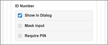

4.11.4.3. ID Number Login
The ID Number login method allows a Person to use their identity number. Identity numbers are convenient when usernames are too long or cumbersome to enter. For example, rather than entering a username like “steven.brown-002”, it is more convenient to enter the employee or student ID Number “3624”.
Admin Web App: Options - User Authentication - ID Number Login
Figure 4.100. Admin Web App: Options - User Authentication - ID Number Login
If the Show in Dialog option is selected, the ID Number login method is part of the Login dialog. When this option is disabled this login can only be achieved by use of the login URL parameter. See Appendix E, URL Cheat Sheet.
When Mask input is set the ID Number will be masked when entered (like a password).
With Require PIN set the user must also provide their associated PIN. This provides additional security for ID Number logins.

If the Show in Dialog option is selected, the Local NFC Card login method is part of the Login dialog. When this option is disabled this login can only be achieved by use of the login URL parameter. See Appendix E, URL Cheat Sheet.
The Format of the card number must be specified. See Section B.1, “Card Number Format”.
This setting applies to any Local Card Reader hooked up to any device. If a card reader is used that produces a different format a Terminal definition with a Custom User Login needs to be created for the device the reader is hooked up to.

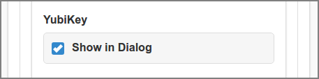

4.11.4.5. YubiKey Login
The YubiKey login method allows a Person to login with a YubiKey Token.
Admin Web App: Options - User Authentication - YubiKey Login
Figure 4.102. Admin Web App: Options - User Authentication - YubiKey Login
If the Show in Dialog option is selected, the YubiKey login method is part of the Login dialog. When this option is disabled this login can only be achieved by use of the login URL parameter. See Appendix E, URL Cheat Sheet.
Get the YubiKey API credentials from yubico.com, and enter them as configuration property.
auth-mode.yubikey.api.client-id
The YubiKey API client ID.
auth-mode.yubikey.api.secret-key
The YubiKey API secret key.
Table 4.10. YubiKey Configuration Properties

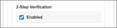

4.11.4.7. 2-Step Verification
2-step verification is a method of confirming a user's claimed identity by utilizing an extra factor after a successful login as discussed in the previous sections. SavaPage uses Time-based One-time Password (TOTP) as described in RFC 6238.
Authenticator apps to generate TOTP codes are widely available.
Admin Web App: Options - User Authentication - 2-Step Verification
Figure 4.104. Admin Web App: Options - User Authentication - 2-Step Verification
When 2-step verification is enabled, users can open the Authentication Dialog to activate their TOTP secret. Then they can utilize their Authenticator app to generate TOTP codes by scanning the QR-code. Or instead, if Telegram TOTP is enabled (see table below), they can choose to have SavaPage send a TOTP code to their Telegram ID. See Section 3.10.2, “Telegram Configuration”.
user.totp.issuer
Issuer in otpauth://totp/[issuer] URI. When void (default) your Organization name is used.
user.ext.telegram.totp.enable
Set to Y (default) or N, to enable/disable sending TOTP code to user Telegram ID.
Table 4.11. 2-Step Verification Issuer Properties

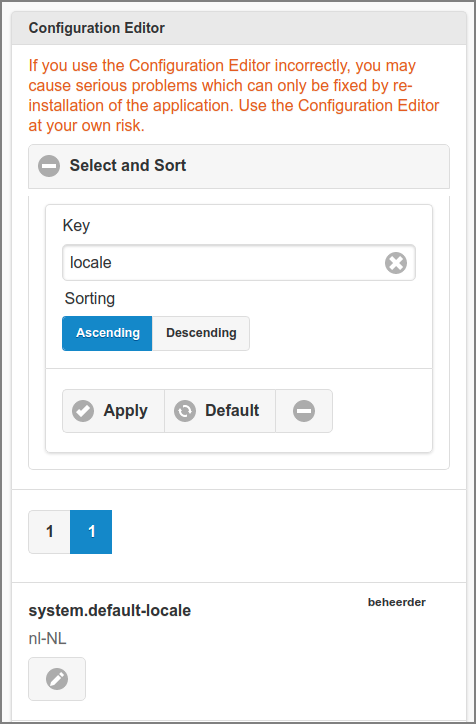

See Section 4.11.15, “Config Editor” on how to set these properties.
2-step verification is not applied when login to the Web App is implicit because of a redirect from a trusted OAuth provider, or trusted and authenticated User Client, or because of a One-Time Authentication Token.

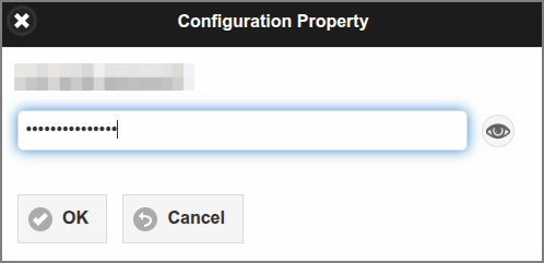

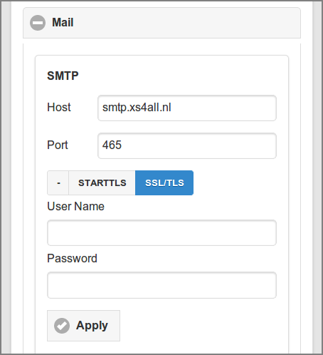

Enter the SMTP connection parameters:
  • The host name or IP address of the Host.
  • The IP port at Port. The standard SMTP ports are: 25 (insecure), 465 (SSL/TLS) and 587 (STARTTLS). The value defaults to 465 (SSL/TLS).
  • Select the connection security: - for an insecure connection, and STARTTLS[21] or SSL/TLS[22] for a secure connection. TLSv1, TLSv1.1 and TLSv1.2 are supported.
  • Enter the User Name and Password if authentication is required. Use the Eye button on the right side of the Password field to show/hide the password. Leave empty to keep the current value.

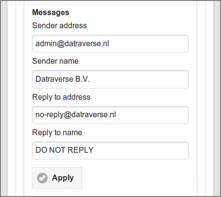

Admin Web App: Options - Mail - Messages
Figure 4.106. Admin Web App: Options - Mail - Messages
The Messages section holds the sender and reply parameters used for email messages send by the system:
  • Sender address : enter a valid email address representing the sender of the message.
  • Sender name : the name default to SavaPage.
  • Reply address : enter a valid email address the recipient can reply to.
  • Reply to name : the name to reply to.
The Sender address must be part of the OpenPGP key used for PGP/MIME email signing and encryption. See Section 13.3, “OpenPGP Settings”.

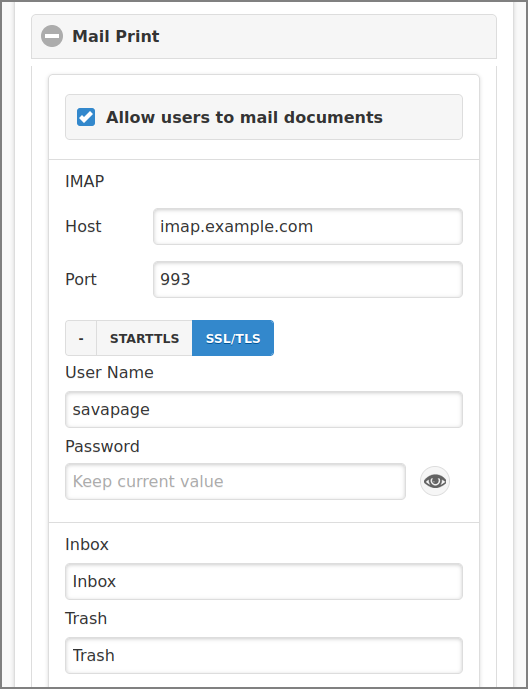

Admin Web App: Options - Mail Print (IMAP)
Figure 4.108. Admin Web App: Options - Mail Print (IMAP)
Check the Allow user to mail documents to enable the Mail Print function. Then enter the IMAP connection parameters:
  • The IP port at Port. The standard IMAP ports are: 143 (insecure), 993 (SSL/TLS) and 143 (STARTTLS). The value defaults to 993 (SSL/TLS).
  • Select the connection security: - for an insecure connection, and STARTTLS or SSL/TLS for a secure connection.
  • Enter the User Name and Password for the required authentication. Leave password empty to keep the current value. Use the Eye button on the right side of the Password field to show/hide the password.
If IMAP OAuth Plug-in is active, User Name and Password are replaced with text “PLUGIN” and the plug-in email address.
The IMAP host must support the IDLE Command, which is a widely implemented standard extension to the core IMAP protocol. See RFC2177.
It is strongly recommended that you use Dovecot, an Open Source IMAP Server, to host Mail Print messages. This is the reference IMAP server used in the SavaPage tests. Other (proprietary) IMAP services may not function as expected.
Print jobs are read from the Inbox and moved to the Trash folder after processing. Enter the name of both folders:
  • Inbox : the name of the Inbox folder.
  • Trash : the name of the Trash folder.
    • When Trash is a sub-folder, enter a point separated folder path. For instance, when Trash is a sub-folder of Inbox, enter: Inbox.Trash

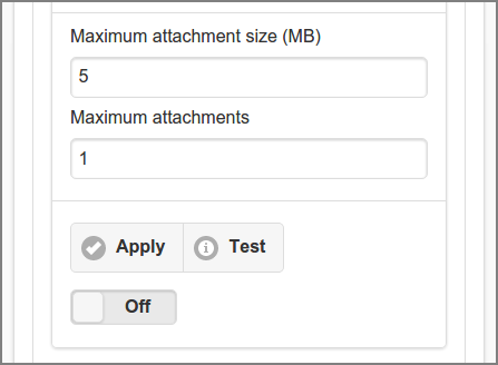

Limit the print job size per email message by setting the Maximum attachment size (MB) and Maximum attachments. Use integers as value. Leave empty to allow unlimited size.
  • Press the Test button to test the connection. A feedback message will be displayed with the result.
  • Use the flip-switch to turn the Mail Print service On and Off. Note that after disabling the service it is automatically turned Off.

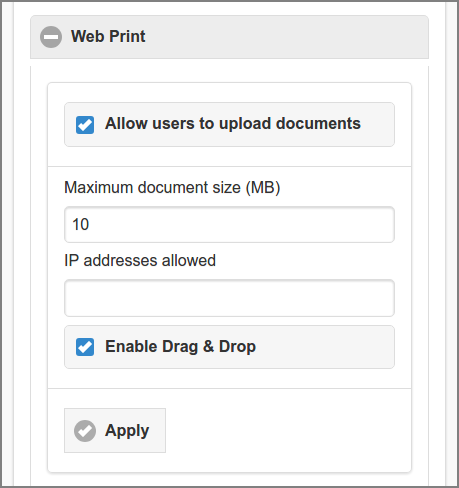

Check the Allow user to upload documents to enable the Web Print function. Then enter the restriction parameters:
  • Limit the print job size by setting the Maximum document size (MB). Use an integer as value. Leave empty to allow unlimited size.
  • Enter IPv4 and/or IPv6 address ranges as a CIDR Set at IP addresses allowed to restrict upload based on the requesting IP address. If the field is empty all requesting IP addresses are allowed to upload. See Section 13.5.5, “HTTP XFF Header Settings”.
  • Enable Drag & Drop creates a Drop Zone in the User Web App main view. See Section 3.12, “Upload Drop Zone”.

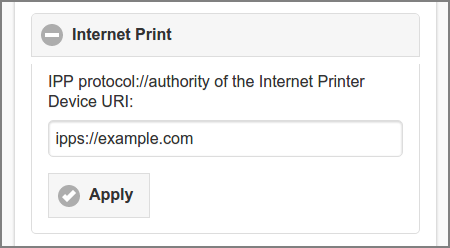

Admin Web App: Options - Internet Print
Figure 4.111. Admin Web App: Options - Internet Print
Enter the protocol://authority of the Internet Printer Device URI as shown to users and press the Apply button to commit. When the value is left blank users won't be able to see their private Internet Printer Device URI. See Section 3.10.1, “Internet Printer”.
Internet Print maps to the reserved Queue /internet. To accept prints from specific IP addresses see Section 4.7.2, “Edit Queue”.
Beware that by enabling Internet Print the SavaPage Web Apps are also accessible over public Internet, so take extra care to protect access to these Apps. See Section 17.3, “Access over Internet”.

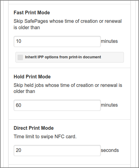

4.11.9.1. Proxy Print Modes
Admin Web App: Options - Proxy Print Modes
Figure 4.113. Admin Web App: Options - Proxy Print Modes
The expiration period for each Print Mode can be entered. See:

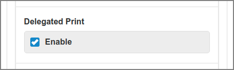

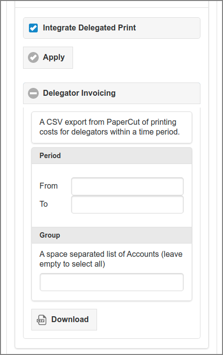

4.11.9.2. Proxy Print Delegation
Admin Web App: Options - Proxy Print Delegation
Figure 4.114. Admin Web App: Options - Proxy Print Delegation
In this section you can Enable Delegated Print: see Section 3.5.4, “Delegated Print” and Section A.3, “Delegated Print Scenarios”.

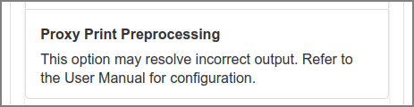

4.11.9.3. Proxy Print Preprocessing
Admin Web App: Options - Proxy Print Preprocessing
Figure 4.115. Admin Web App: Options - Proxy Print Preprocessing
If your Proxy Printer instances consistently deliver incorrect print output, preprocessing (converting) the PDF before sending it to CUPS could be a solution. The following global configuration properties apply for all printers:
proxy-print.convert
Y, N (default). Set to Y to enable Proxy Print Preprocessing, i.e. PDF conversion.
proxy-print.convert.suspend
Y, N (default). Set to Y to suspend conversion just before sending the job to CUPS. Set to N if conversion is to be applied as early as possible, e.g. when creating a Job Ticket or Hold Print Job.
proxy-print.convert.grayscale
Y, N (default). Set to Y to convert PDF to grayscale.
proxy-print.convert.rasterize
Y, N (default). Set to Y to rasterize the PDF.
proxy-print.convert.rasterize.zero.fonts
Y, N (default). Set to Y to rasterize even if no fonts are detected in the PDF.
proxy-print.convert.rasterize.dpi
Enum DPI values of rasterized PDF: DPI_100, DPI_150, DPI_200, DPI_300 (default), DPI_600.
proxy-print.convert.rasterize.max.bytes
PDF file size (bytes) as limit above which no conversion is done. Value 0 (default) sets no limit.
proxy-print.convert.rasterize.max.pages
Number of PDF pages as limit above which no conversion is done. Value 0 (default) sets no limit.
Table 4.14. Proxy Print Preprocessing: Configuration Properties
See Section 4.11.15, “Config Editor” on how to change these properties.

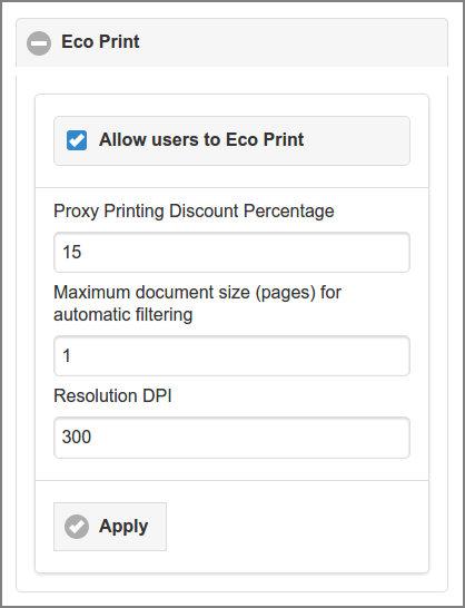

Admin Web App: Options - Eco Print
Figure 4.116. Admin Web App: Options - Eco Print
Check the Allow users to Eco Print to enable the Eco Print function. Then specify:
  • A Proxy Printing Discount Percentage (integer) to be applied to proxy printing costs as specified for any Proxy Printer. See Section 4.8.2, “Edit Proxy Printer”.
  • The Maximum document size (pages) for automatic filtering. In this example the value of “1” means that any document printed to SavaPage with 1 page is automatically filtered in the background. A value of “3” will automatically filter incoming documents of 3 pages or less. A value of “0” disables this automatism.
  • The Resolution DPI of the Eco Print page image.

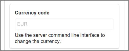

4.11.11.1. Currency Code
Admin Web App: Options - Financial - Currency
Figure 4.117. Admin Web App: Options - Financial - Currency
The ISO 4217 currency code of the financial subsystem can be entered here during installation. When the application status is “ready-to-use” the code can only be changed by using a Server Command. See Section C.1.4, “changeBaseCurrency”.

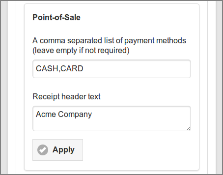

4.11.11.3. Point-of-Sale
Admin Web App: Options - Financial - POS
Figure 4.119. Admin Web App: Options - Financial - POS
These are the options for the Point-of-Sale:
  • Payment methods: see Section 7.3, “Deposit”.
  • Receipt header text: this typically contains a legal text placed in the Receipt header.

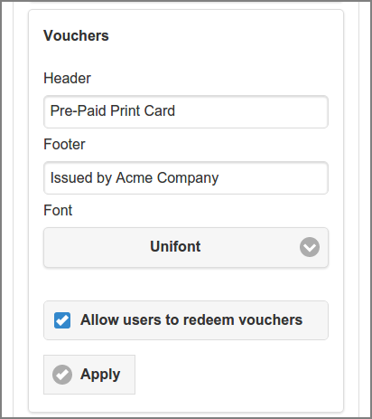

4.11.11.4. Vouchers
Admin Web App: Options - Financial - Vouchers
Figure 4.120. Admin Web App: Options - Financial - Vouchers
These are the options for the Voucher System:
  • Header: the header text of the voucher card.
  • Footer: the footer text of the voucher card.
  • Font: the font used for the PDF Document with vouchers. See Section 19.2, “Internal Fonts”.
  • You need to explicitly Allow users to redeem vouchers.

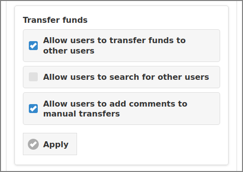

4.11.11.5. Transfer Funds
Admin Web App: Options - Financial - Transfer funds
Figure 4.121. Admin Web App: Options - Financial - Transfer funds
These settings apply to Transfer Credit dialog in the User Web App. Check the options to Allow users to transfer funds to other users, to Allow users to search for other users and to Allow users to add comments to manual transfers.
The minimum and maximum amount to transfer are held in the configuration properties financial.user.transfers.amount-min and financial.user.transfers.amount-max. They can be changed with the Configuration Editor.

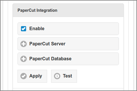

4.11.12.1. PaperCut Integration
PaperCut is a popular print and copy management software product developed by PaperCut Software. Some functions not present in PaperCut can be implemented with SavaPage as pre-processor and integrator. See Appendix N, PaperCut Integration.

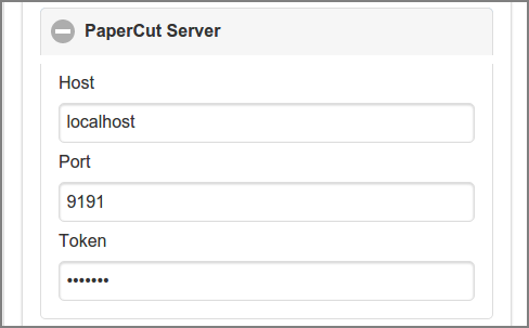

When PaperCut Integration is enabled, connectivity parameters for the PaperCut Server (XML-RPC API) and PaperCut Database (JDBC) can be entered. Press the Apply button to commit the changes. Press the Test button to test the PaperCut connectivity: a message confirming the connection status is displayed.
Admin Web App: Options - PaperCut Integration
Figure 4.122. Admin Web App: Options - PaperCut Integration
Admin Web App: Options - PaperCut Server
Figure 4.123. Admin Web App: Options - PaperCut Server
The Token must match the value of the auth.webservices.auth-token item in the PaperCut Config Editor. Use the Eye button on the right side of the entry field to show/hide the token. Leave empty to keep the current value.

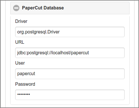

Admin Web App: Options - PaperCut Database
Figure 4.124. Admin Web App: Options - PaperCut Database
Admin Web App: Options - PaperCut Delegated Print Integration
Figure 4.125. Admin Web App: Options - PaperCut Delegated Print Integration
When Proxy Print Delegation is enabled, the Integrate Delegated Print option is shown. If this option is selected, the Delegator Invoicing subsection is exposed where printing cost totals for delegators from selected Accounts, within a certain time period, can be exported. The result is a CSV file with a line for each delegator. Lines are ordered by user id and specify the cost total within the period and extra data like account and number of transactions per job type, like duplex/simplex,color/grayscale, page format A4, A3, etc. See PaperCut User Prints.
For each Delegator line in the CSV file, a "class" is specified, which is one of the user groups used as selection context for the Delegator total (actually it is the alphanumeric MAX of all contexts involved in the total). Therefore, "class" is only an indication and does not stand for unique group membership. If you want to know what has been charged within a certain selection context, you can specify one or more accounts (classes) as selection.

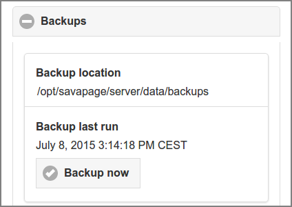

4.11.13. Backups
The Backups section shows the backup location and time of the last backup.
Admin Web App: Options - Backups
Figure 4.127. Admin Web App: Options - Backups
Press the Backup now button to launch the backup process in the background. The progress and result of the process is not echoed real-time in this section, but can be monitored in the Real-time Activity section of the Dashboard. Also see Section C.5.6, “db-export and db-export-to”.

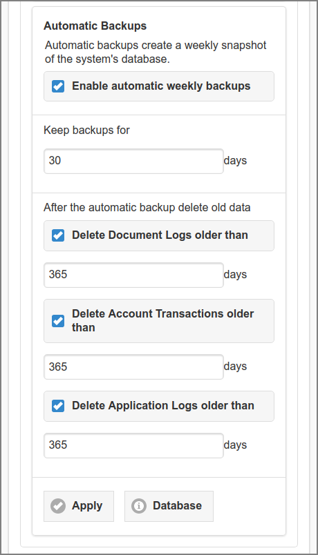

Admin Web App: Options - Automatic Backups
Figure 4.128. Admin Web App: Options - Automatic Backups
The Automatic Backups section holds options for creating weekly snapshots of the database.
  • Tick the Enable automatic weekly backups checkbox to enable the process. See Weekly Jobs.
  • The number of days a backup should be kept, must be entered at Keep backups for.
  • A purge of old log data, executed after the backup, can be activated by selecting the Delete older than check-boxed for Application Logs, Document Logs and Transaction Logs. Please enter the number of days the logs should be held.
  • Press the Database button to show a pop-up with the number of documents (received, printed, downloaded) and transactions in the database.

4.11.14.1. User Client Authentication
The User Client uses the system account name of the user to identify itself to the SavaPage server. In a strict Single Sign-On (SSO) environment, where a user is already logged in and authenticated as domain user, the system account name can be trusted by default. In environments where non-domain systems are allowed, local accounts are not authenticated by domain services, and therefore can not be trusted.
Admin Web App: Options - Advanced - User Client
Figure 4.129. Admin Web App: Options - Advanced - User Client
User Client uses the system account name as user identification (unless overridden by a command line option).
  • If Trust system user is enabled the User Client will trust the system account name.
  • If Trust system user is disabled the User Client will pop-up a login dialog to authenticate the user, unless the following trust sources are available:
    • If Trust User Web App is enabled and the user is already authenticated in a User Web App on the same IP address, User Client will trust the Web App user as user identification.
    • If an administrator uses the secret Admin passkey in the start-up script it will enforce trust of the offered user identification. See Chapter 11, User Client. Use the Eye button on the right side of the entry fields to show/hide the passkey.
  • Press the Apply buttons to commit the changes.

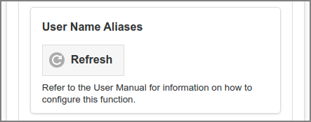

4.11.14.2. User Name Aliases Cache
User Name Aliases are stored in a file whose content is read and cached when the SavaPage service is started. You can Refresh the cache after you edited the file content.
Admin Web App: Options - Advanced - User Name Aliases
Figure 4.130. Admin Web App: Options - Advanced - User Name Aliases

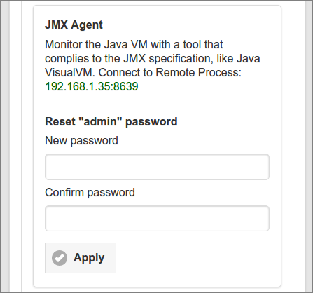

4.11.14.3. Admin Password
The Reset internal admin password section is the place to change the master password for the built-in admin account.
Admin Web App: Options - Advanced - Reset Admin Password
Figure 4.131. Admin Web App: Options - Advanced - Reset Admin Password
  • Enter the new password twice at New password and Confirm password.
  • The password must contain the same minimum number of characters as defined for Internal Users. See Section 4.4.6, “Create Internal User”.
  • Use the Eye button on the right side of the entry fields to show/hide the password.
  • Press the Apply button to commit the change.
Keep the new password at a secure place, since it is the master key to your system.
4.11.14.4. JMX Agent
SavaPage runs in a Java Virtual Machine, which has built-in instrumentation that enables client applications to monitor and manage it with the help of Java Management Extensions (JMX). SavaPage configures the built-in JMX agent for remote monitoring, so it can be securely accessed by remote client management applications, such as Java VisualVM or JConsole.
This section shows the JMX remote process connection string, and enables you to reset the admin connection password. Use the Eye button on the right side of the entry fields to show/hide the password.
Admin Web App: Options - Advanced - JMX Agent
Figure 4.132. Admin Web App: Options - Advanced - JMX Agent
Java VisualVM is the standard Java JMX client that was first bundled with the Java Development Kit (JDK) version 6, update 7. It can be found in JDK_HOME/bin, where JDK_HOME is the directory where the JDK is installed.
If JDK_HOME/bin is in your system path, you can start Java VisualVM by simply typing jvisualvm in a command (shell) prompt. Otherwise, you have to type the full path to the executable file.
Since SavaPage enforces SSL for remote JMX communication, jvisualvm needs to be started with two special parameters referring to the Java truststore, holding the trusted SSL certificate, and the truststore password.
The shared client directory /opt/savapage/client/jmx contains the JMX server certificate jmxremote.crt, a ready to use jmxremote.ts truststore, and a sample GNU/Linux and Mac shell script jmxremote.sh and Windows command file jmxremote.cmd to start jvisualvm with the right parameters.
The password of the provided jmxremote.ts truststore is: savapage. Of course you are free to import jmxremote.crt into your own truststore and use it with your own password.
Add JMX Connection with Java VisualVM
Figure 4.133. Add JMX Connection with Java VisualVM
Add a new JMX Connection and enter the IP address and port number of the Connection and as shown in the JMX Agent section, in our case this would be 192.168.1.35:8639.
Enter the Username admin and the Password as set in the JMX Agent section above. Press the OK button to save the connection and start it from the Java VisualVM Applications pane.
Older JDK versions have JConsole as standard JMX client. If you want to use JConsole copy and edit the scripts in /opt/savapage/client/jmx so jconsole is used instead of the default jvisualvm.
Connecting to Remote Process with JConsole
Figure 4.134. Connecting to Remote Process with JConsole
When starting JConsole it prompts you to enter the parameters for the New Connection. Select the Remote Process option and enter the IP address and port number as shown in the JMX Agent section, in our case this would be 192.168.1.35:8639.
Enter the Username admin and the Password as set in the JMX Agent section above. Press the Connect button to open the connection.
More information about the JMX configuration can be found in Section 17.7, “Secured JMX Connection”.

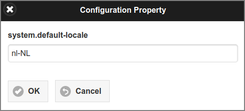

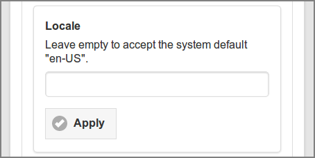

4.11.14.5. Locale
Enter the System Locale string at the Locale section.
Admin Web App: Options - Advanced - Locale
Figure 4.135. Admin Web App: Options - Advanced - Locale
  • The format of the locale conforms to IETF BCP 47.
  • Some examples are: en, en-GB, en-US, nl, nl-NL, nl-BE.
  • You can leave the locale empty to accept the system default.
  • The locale is applied to all system messages which are logged in the system log or send by email.
This system locale is not used for the language and country default used in the Web App. The Web App default is picked up from the locale settings of the Web browser, optionally overruled by the language and country URL parameters. See Appendix E, URL Cheat Sheet.

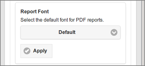

4.11.14.7. Report Font
The Report Font is used as default font for all PDF reports.
Admin Web App: Options - Default Paper Size
Figure 4.137. Admin Web App: Options - Default Paper Size

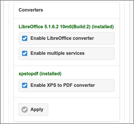

4.11.14.8. Converters
Converters are used to convert files offered for printing via Web Print or Mail Print to PDF. This is the place to enable the converters. For installation see:
Admin Web App: Options - Converters
Figure 4.138. Admin Web App: Options - Converters
When Enable multiple services is checked, the LibreOffice converter acts as multi-threaded load-balancing service for easy upscaling of conversion throughput. The configuration properties that determine the behavior of this service are summarized in the table below. The defaults will work fine in most situations. By adding extra soffice.connection.ports you can enhance conversion throughput, as long as hardware resources permit.
Tuning LibreOffice configuration values is an advanced task. Please consult your SavaPage Service Provider about which values give the best performance in your situation. Then use the Configuration Editor to change the defaults.
soffice.home
The LibreOffice home location. When empty, a probe to likely candidates is performed to retrieve the location. Default: empty.
soffice.profile.template-dir
When empty, a temporary profile directory is created for each UNO connection process with its own defaults settings. Otherwise, this configuration property must provide a profile directory containing customized settings. This template directory will be copied to the temporary profile. Default: empty.
A comma/space separated list of TCP/IP ports to localhost LibreOffice (UNO) connection instances to be launched by SavaPage. Default: 2002,2003
soffice.connection.restart-task-count
The number of executed tasks after which a UNO connection is restarted. When 0 (zero) the connection is never restarted. Default: 200
soffice.task.queue-timeout-msec
Wait time (milliseconds) for a UNO connection to become available for task execution. Default: 10000
soffice.task.exec-timeout-msec
Wait time (milliseconds) for a conversion task to complete. Default: 20000
soffice.respond.retry-msec
Retry interval (milliseconds) for host process to respond. Default: 250
soffice.respond.timeout-msec
Wait time (milliseconds) for host process to respond (after retries). Default: 30000
soffice.start.retry-msec
Retry interval (milliseconds) for host process to start. Default: 1000
soffice.start.timeout-msec
Wait time (milliseconds) for host process to start (after retries). Default: 120000
Table 4.15. LibreOffice Configuration Properties

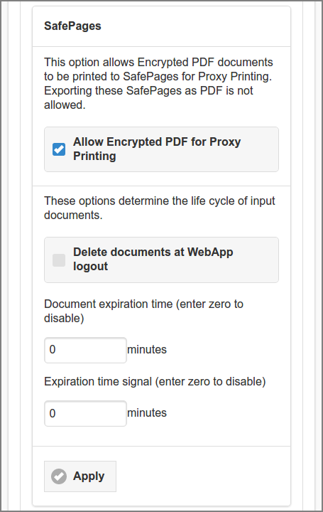

This section contains advanced options regarding encrypted PDF and the expiration of SafePages input documents.
Admin Web App: Options - Advanced - Proxy Printing
Figure 4.139. Admin Web App: Options - Advanced - Proxy Printing
  • When the Allow Encrypted PDF for Proxy Printing option is enabled, Encrypted PDF documents with Printing as allowed action, are accepted as SafePages. However, SavaPage will protect the encryption of the original document, i.e. its pages are not allowed to be exported (downloaded or send) as PDF, directly, or as part of a composite document. When this option is disabled, all Encrypted PDF files are rejected. Encrypted PDF can be offered by:
  • When Delete documents at Web App logout is checked all print-in documents are deleted when the users logs out.
  • Document expiration time manages the input document life cycle. Any document older than the number of entered minutes is considered expired and will be automatically deleted. For instance, a value of 1440 will delete the SafePages document 24 hours after it was printed. The expiration time is shown in the Document Details dialog. The user is notified by pop-up after an expired document is auto-deleted. User action is required to close the pop-up. This way we are sure the user noticed the delete and expectation is set right.
    • When a user logs out and logs in again after some time, expired documents will be auto-deleted to begin with, but the user will not be notified of this event.
    • Expired documents whose deletion is not triggered by an active User Session or Fast Print release are eventually deleted during User Home Clean.
  • Use the Expiration time signal value to signal the user when expiration is due. For instance, a value of 15 will mark the document thumbnails with a clock icon in a colored (orange) footer, 15 minutes before expiration. This will alert the user, so he can do some last minute actions on old documents.

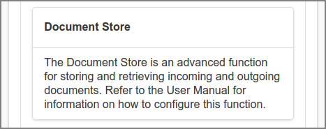

4.11.14.10. Document Store
Admin Web App: Options - Advanced - Document Store
Figure 4.140. Admin Web App: Options - Advanced - Document Store
Document Store is a generic solution to store and retrieve different kind of documents. Namely, documents Printed to SavaPage, Downloaded as PDF or printed to Proxy Printers. Each kind of document is persisted in a separate storage branch, based on its source or destination.
  • Documents are either stored for an extended or limited period of time. These two period types correspond with two types of stores: Archive for long-term, and Journal for short-term storage.
    • When in a use case, Archive and Journal are both applicable for the same branch, the Archive branch takes precedence to store the document.
  • Document Store is persisted on the host file system, as described in Appendix F, File Locations: path /opt/savapage/server/data/doc-archive and /opt/savapage/server/data/doc-journal.
    • Documents are stored with their metadata in a unique identifying file path of year, month, day, hour and document UUID. Expired documents are deleted at a daily schedule. Deletion is a technical operation where file path branches are pruned according to their timestamp fingerprint [23]. If you want to keep a branch beyond the time limit, make sure to back-up the corresponding file path in time.
  • Stored documents can be retrieved (downloaded) from the Document Log in all Web Apps.
  • Currently Print Archive and Print Journal branches are supported for Proxy Print Jobs. When needed other branches can be implemented.
Use the following configuration properties:
doc.store.enable
Set to Y or N (default), to enable/disable the Document Store.
doc.store.free-space-limit-mb
The minimum MB of free space needed. When free space falls below this value, the store will be disabled till more space is available. Default: 5000.
Archive branch
doc.store.archive.enable
Set to Y or N (default), to enable/disable the doc-archive/ branch.
doc.store.archive.out.enable
Set to Y or N (default), to enable/disable the doc-archive/out/ branch.
doc.store.archive.out.print.enable
Set to Y or N (default), to enable/disable the doc-archive/out/print/ branch.
doc.store.archive.out.print.days-to-keep
Number of days a Print Out Archive document is kept in store. Default: 30. Cleaning is a Daily Job.
doc.store.archive.out.pdf.enable
reserved for future use
doc.store.archive.out.pdf.days-to-keep
doc.store.archive.in.enable
doc.store.archive.in.print.enable
doc.store.archive.in.print.days-to-keep
Journal branch
doc.store.journal.enable
Set to Y or N (default), to enable/disable the doc-journal/ branch.
doc.store.journal.out.enable
Set to Y or N (default), to enable/disable the doc-journal/out/ branch.
doc.store.journal.out.print.enable
Set to Y or N (default), to enable/disable the doc-journal/out/print/ branch.
doc.store.journal.out.print.days-to-keep
Number of days a Print Out Journal document is kept in store. Default: 2. Cleaning is a Daily Job.
doc.store.journal.out.pdf.enable
doc.store.journal.out.pdf.days-to-keep
doc.store.journal.in.enable
Set to Y or N (default), to enable/disable the doc-journal/in/ branch.
doc.store.journal.in.print.enable
Set to Y or N (default), to enable/disable the doc-journal/in/print/ branch.
doc.store.journal.in.print.days-to-keep
Number of days a Print In Journal document is kept in store. Default: 2. Cleaning is a Daily Job.
Table 4.16. Document Store Configuration Properties

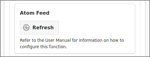

4.11.14.12. Atom Feed
Press the Refresh button to publish an Atom Feed outside the publication schedule. See Section C.3, “Atom Feed Service”.
Admin Web App: Options - Advanced - Atom Feed
Figure 4.142. Admin Web App: Options - Advanced - Atom Feed

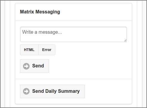

4.11.14.13. Matrix Messaging
This section is visible depending on Matrix configuration properties. See Section C.4, “Matrix Messaging Service”.
Press the Send button to send a message, optionally formatted as HTML and/or as Error. Press the Send Daily Summary button to send an ad hoc daily summary outside the messaging schedule.
Admin Web App: Options - Advanced - Matrix Messaging
Figure 4.143. Admin Web App: Options - Advanced - Matrix Messaging

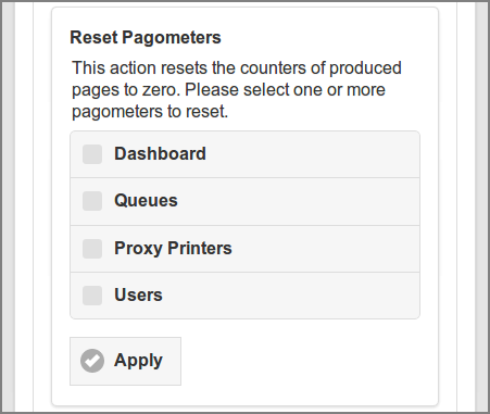

4.11.14.14. Pagometers
In analogy with the term Odometer, the term Pagometer is coined as an instrument to count the number of processed pages of SavaPage input and output documents. Pagometers are used to display usage statistics and Printing Impact from a global viewpoint as in the Dashboard, or in specialized views for User and Users, Queues and Proxy Printers. The counters can be reset in the Reset Pagometers section.
Admin Web App: Options - Advanced - Pagometers
Figure 4.144. Admin Web App: Options - Advanced - Pagometers
  • Tick the checkboxes of the pagometers to reset.
  • Press the Apply button to execute the action.
4.11.15. Config Editor
Most of the SavaPage configuration properties can be edited in dedicated sections of the Admin Web App. However, many extra properties are present without an editing interface. Luckily a generic Configuration Editor is available for editing individual configuration properties, so the defaults of "hidden" properties can be changed when needed.
If you use the Config Editor incorrectly, you may cause serious problems which can only be fixed by re-installation of the application. Use the Config Editor at your own risk.
Tap the Configuration Editor (advanced) button to start the editor. See Figure 4.145, “Admin Web App: Configuration Editor - List” for a detailed description.
Figure 4.145. Admin Web App: Configuration Editor - List
  • All configuration properties are listed alphabetically by default with their key and value. Secret values are encrypted and shown as ******** in the list, see Section 17.8, “Encrypted Secrets”.
  • Push the Select and Sort button to expand (collapse) the section.
  • Select items by entering a fragment) of their key. So, entering "ldap" will select "auth.ldap.port" and "ldap.schema.group-member-field".
  • The list can be sorted Ascending or Descending on name.
  • A tap on the Default button resets the selection and sort field to their default values.
  • Tap the Edit button to edit the item. See Figure 4.146, “Admin Web App: Configuration Property - Edit”.
Due to Admin Privileges the Edit button might not be visible.
The Configuration Editor can also be launched from the Action Pop-up Menu at the footer of Admin Web App.
Figure 4.146. Admin Web App: Configuration Property - Edit
  • The value of the item is shown in the entry field and can be edited.
  • Press the OK button to commit the change and return to the list.
  • The Cancel button brings you back to List without changing anything.
Admin Web App: Configuration Property - Edit Secret
Figure 4.147. Admin Web App: Configuration Property - Edit Secret
  • Secret values are shown in a password entry field.
  • Use the Eye button on the right side of the entry field to show/hide the secret.
